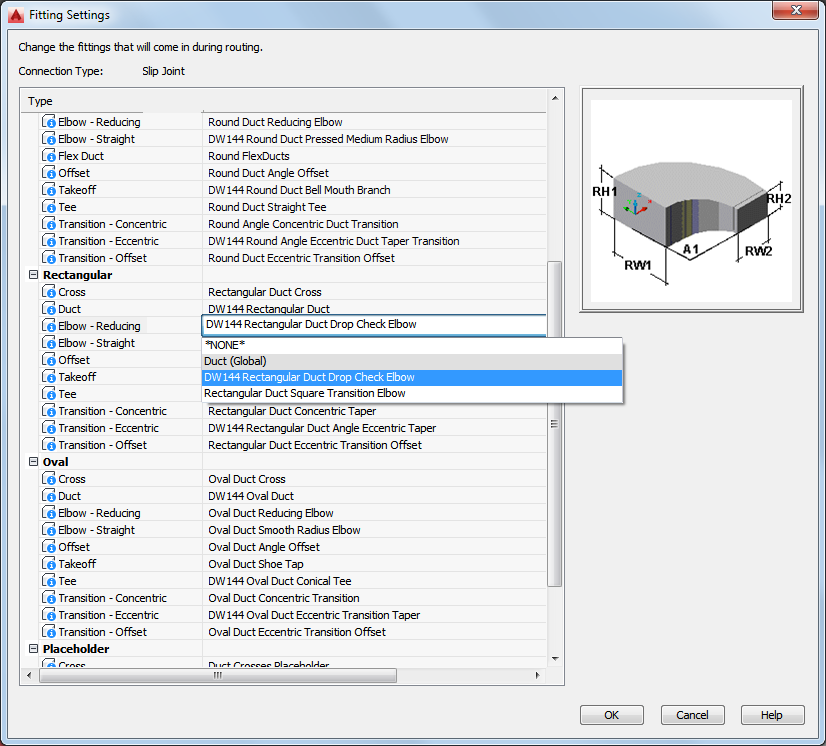

A duct part routing preference includes one or more size ranges for duct parts and fittings, such as elbows, tees, cross, takeoff, and transitions. The software organizes the size ranges based on nominal duct sizes. You can use duct parts and fittings in a specified size range as you lay out the duct run. The available duct parts are specific to the connection type you select. The following example shows the routing preferences for the connection type Slip Joint baed on shape for the Global profile.
Routing preferences, showing parts organized based on connection type
Multiple size ranges provide more flexibility in your duct designs.
When you configure a routing preference for a particular specification, the appropriate fittings are automatically inserted into the duct layout.
