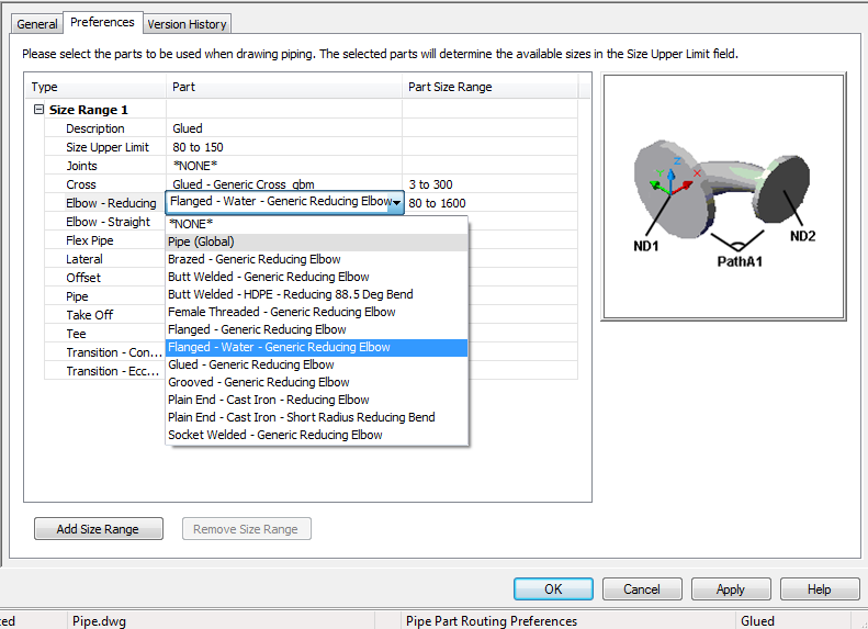

A pipe part routing preference includes one or more size ranges for pipe parts and fittings, such as elbows, tees, laterals, and transitions. The software organizes the size ranges based on nominal pipe diameters. You can use pipe parts and fittings in a specified size range as you lay out the pipe run. The following example shows the routing preferences for Glued. Notice that the available Pipe parts are organized based on material type for US Imperial and US Metric profiles.
Routing preferences, showing parts organized based on material type
