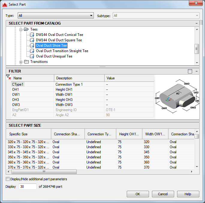

  2. On the Properties palette General, click the part image next to Part.
  3. In the Select a Part dialog box, select a part from the catalog.
    Under Select Part from Catalog, the dialog box organizes duct fittings based on shape type.
  4. (Optional) Select Display/Hide additional part parameters to expand the contents of the parameters table.
  5. Use the filter to sort through the list of parts.
    Note: The part catalogs and content locations determine the parts that you can select.
  6. Select a part size.
