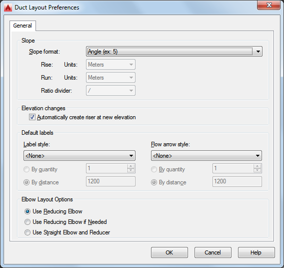

The General tab in the Duct Layout Preferences dialog controls duct layout preferences for slope, elevation, labels, flow arrows and elbow preference.
General tab
- Slope preferences. On the General tab of the Duct Layout Preferences dialog, select a slope format.
Slope format affects the Slope property in the Properties palette. Slope format is stored with the drawing. The list includes the following formats:
| Slope format |
Description |
| Angle |
Expressed in degrees (for example, 2 degrees) |
| Percentage |
Expressed as a percent, where 100%=45 degrees |
| Percentage |
Expressed as a percent, where 100%=90 degrees |
| Rise/Run |
Expressed as a fraction (for example, 1/48 or 1/100) Note: The Slope property in the Properties palette is displayed as a fraction.
- Select drawing units for Rise and for Run.
The Units list is only turned on if you first selected a slope format. The units in the list are derived from the current profile and from selections made in the Drawing Setup dialog in AutoCAD Architecture. For example, for Metric, you can choose meters, millimeters, etc. For Imperial, you can choose feet or inches.
- Enter a Constant value.
You can only edit constant value for Rise if you previously selected Rise/Run with Constant Rise for Slope format. You can only edit constant value for Run if you previously selected Rise/Run with Constant Run for Slope format.
- Select slash (/) or colon (:) for the preferred ratio divider.
- Elevation preference. Select Automatically create riser at new elevation to turn on this layout behavior.
- Label preferences. Select a label style.
Label preferences are stored in the registry.
Note: If you select None, skip the next step.
- Select By quantity or By distance:
- For By quantity, enter the number of labels to add to each straight segment.
- For By distance, enter a segment length. If the segment length is less than the interval distance, a label is not automatically added to that segment.
- Flow arrow preferences. Select a flow arrow style from the list.
- Select By quantity or By Distance:
- For By quantity, enter the number of flow arrows to add to each straight segment.
- For By distance, enter a segment length. If the segment length is less than the interval distance, a flow arrow is not automatically added to that segment.
- Elbow layout options. Do one of the following:
- Select Use Reducing Elbow to add a single fitting when changing the direction of the duct run and the size of the duct.
- Select the Use Reducing Elbow if needed to not add a reducing elbow fitting when the duct size does not change.
- Select Use Straight Elbow and Reducer to add 2 fittings, an elbow and a reducer, when changing the direction of the duct run and the size of the duct.
The following examples show label, flow arrows, reducing elbow and straight elbow and reducer in a duct run:
Labels
Flow Arrows Spaced Evenly, 1 per segment
Reducing elbow
Straight elbow and reducer
