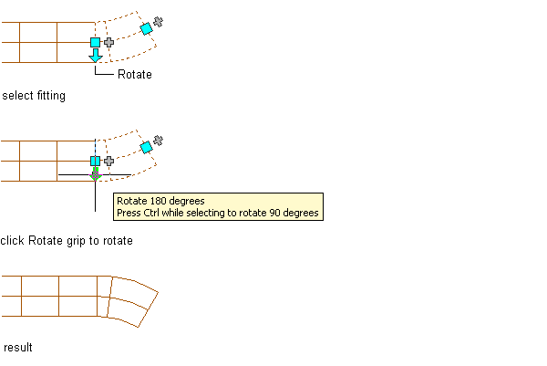

You can use arrow-shaped (  ) Rotate grips to rotate cable tray and conduit fittings 180 or 90 degrees in the direction indicated by the grip.
Rotating a cable tray fitting 180 degrees in plan view

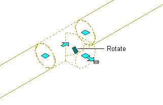

In isometric views, you can also use diamond-shaped (  ) Rotate grips to rotate conduit fittings around the centerline to any angle.
A conduit tee fitting in an isometric view

    rotate the fitting 180 degrees (flip the fitting) click the Rotate grip (  ).
    rotate the fitting 90 degrees while pressing Ctrl, click the Rotate grip (  ).
