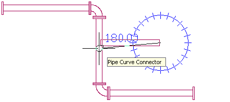

There are 2 types of AutoCAD MEP snaps: end connectors (often referred to as just connectors) and curve connectors. Use end connectors to connect new objects to the ends of existing objects. Use curve connectors to connect new objects anywhere along the centerlines of existing objects.
When you use AutoCAD MEP snaps, the software inserts an appropriate fitting when needed, as shown in the following example of adding a pipe branch.
Snapping a pipe to an existing run using the pipe curve connector
Resulting branch with an inserted fitting
