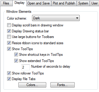

To specify the information displayed in AutoCAD MEP tooltips
  1. Click Options.
  2. In the Options dialog, click the Display tab.
  3. Under Window Elements, specify the desired tooltip options.
    You can also control the color, size, and transparency of tooltips.
