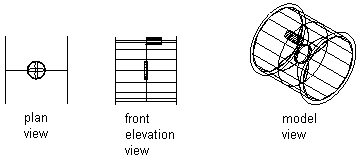

Different views of a mechanical part

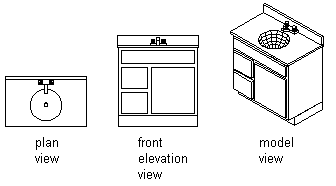

Different views of a plumbing part
