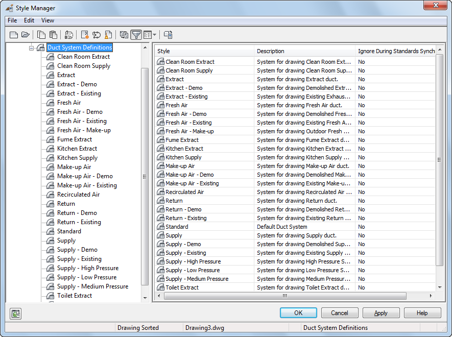

Systems are style-based, and, as a result, you access them through Style Manager.
Duct systems
Systems are loaded through AutoCAD MEP templates. If you are not using an AutoCAD MEP template, you can import system definitions from other drawings with Style Manager. Additional system definitions can be found in the System Definitions.dwg, which is located in a subfolder of the following folder: \ProgramData\Autodesk\MEP <version>\enu\Styles.
