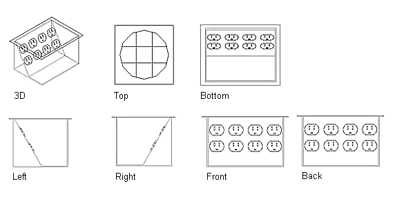

For each view of style-based content, additional view blocks must be created and assigned to a specific view in the style definition. The assigned views determine the appearance of the style-based content in your drawing. For orthographic views, you can create 6 plan/elevation view blocks and assign them to each ortho view respectively, or use a 3D model block to represent the ortho view. For information on view settings, see Defining the Views of a Style.
Orthographic view directions (for recessed double duplex receptacle)

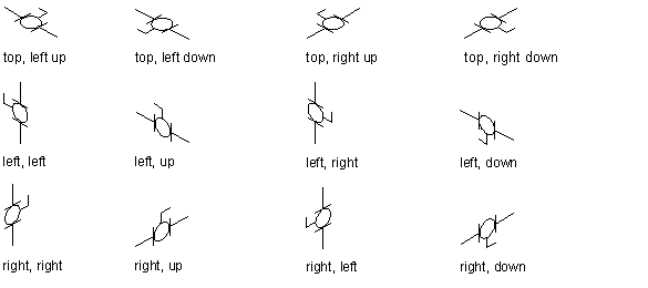

For isometric views, twelve view blocks should be created for each piece of style-based content.
Isometric view directions and orientations
