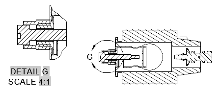

Model Edge
- Smooth
- Sets the cut lines on the models in detail views to be smooth.
| applied to model documentation detail views |
applied to AMDETAIL detail views |

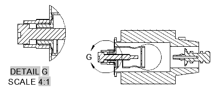

- Smooth with border
- Displays a border around detail views and sets the cut lines on the models shown in detail views to be smooth.

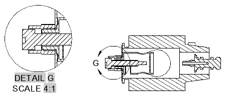

- Smooth with connection line
- Displays a connection line between the detail border and the detail view boundary. Additionally, displays a border around detail views and sets the cut lines on the models shown in detail views to be smooth.

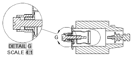

- Jagged
- Sets the cut lines on the models in detail views to be jagged.
Note: AMDETAIL detail views do not support jagged cut lines. When this option is selected, AMDETAIL drawing views behave as though the Smooth option is selected.
