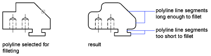

You can fillet all vertexes of a polyline at the same time.
Note:
Only the segments long enough to accommodate the fillet is filleted.

Enter P for polyline.
On the ribbon, in the Fillet Options panel, check the fillet size. To change the fillet radius:
Click
<Current tab>
Fillet Size drop-down
Find
Select the desired fillet size from the drop-down.
Click an empty space in the drawing area.
Select the polyline.
