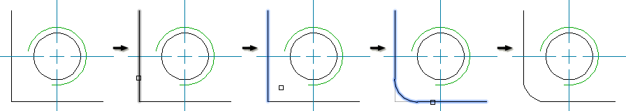

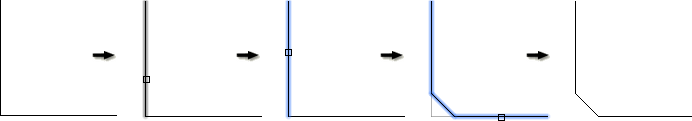

The AMCHAM2D and AMFILLET2D commands now display a preview of what the chamfered or filleted corner looks like. After you select the first object for the chamfer or fillet, the selected object highlights. As you move the cursor over the second object, it highlights, and shows a preview of what the corner looks like if you select that object.
Example 1: AMCHAM2D Command
Example 2: AMFILLET2D Command
