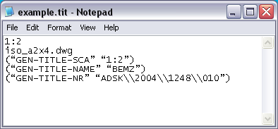

The first two lines of the file must contain the following:
Use the remaining lines, which are optional, to map attributes from the drawing title block to the appropriate associated text, for example:
Such a text file can look like:
