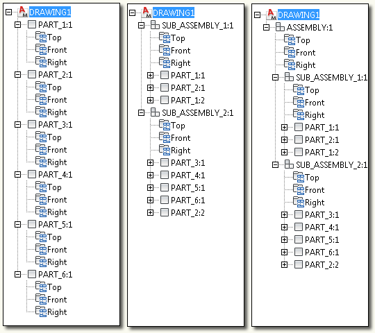

For example, in a 2D environment, a part or assembly is typically represented by one or more views. To support this, mechanical structure provides a mechanism to group geometry as views of components (as opposed to grouping geometry directly for a component). In the mechanical browser tree, component views are directly attached to component nodes. Each component contains one or more component views.
In the mechanical browser, a part is a component that consists of component views only. An assembly is a component that contains other components.
