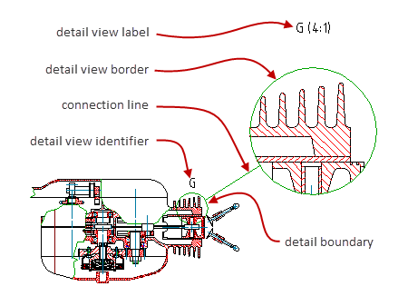

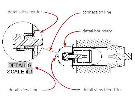

A detail view style is a named collection of settings that control the appearance of detail boundaries, identifiers, and labels of detail views.
| model documentation detail views | AMDETAIL detail views |
The settings that control the appearance of AutoCAD Mechanical objects are saved to a named collection of settings known as the drafting standard. As such, the manner in which detail view styles apply to AutoCAD objects (model documentation detail views) is different to how they apply to AutoCAD Mechanical objects (AMDETAIL detail views). Accordingly;
Each detail view style is considered a revision of the drafting standard. AutoCAD Mechanical detail view styles are indicated by the
icon, while AutoCAD detail view styles are indicated by the
icon.
Only AutoCAD Mechanical detail view styles can inherit text and leader settings from the master settings of the drafting standard.
When the text height of detail view labels and identifiers are set to “By NameOfCurrentDraftingStandard,” they automatically take on a text height that is one size larger than the base height master setting. There by detail view labels and identifiers become larger than dimension, note, and symbol text. If you modify the master settings, the text size of detail view labels and identifiers automatically update.
New detail view styles you create from the Detail View Styles Manager are created as AutoCAD detail view styles. Never as AutoCAD Mechanical detail view styles. AutoCAD Mechanical detail view styles are part of the drafting standard and are created automatically.
AMDETAIL detail views always follow the current detail view style specified as part of the drafting standard. Model documentation detail views use the current detail view style to obtain its default settings. As long as you don't override the default settings model documentation detail views also follow the drafting standard settings used by AMDETAIL detail views.
