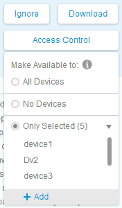

  1. In the Account Portal, click PRODUCTS & SERVICES Product Updates.
  2. Click an update that you want to distribute, and then click Access Control.
  3. On the Access Control menu, select All Devices, No Devices, or the list of selected devices.
    The Access Control Menu

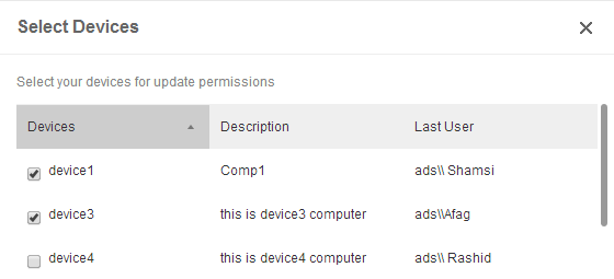

    1. If you want to add or remove devices from the selected list, click +Add.
      The Select Devices dialog opens.
    2. In the Select Devices dialog, select or clear check boxes for specific devices.
      Note: In a long list of devices, you can click a column to sort the table by that column in ascending or descending order.
    3. Click Select to close the Select Devices dialog.
