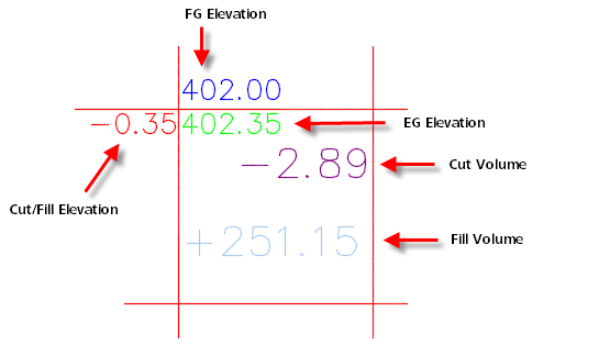

  9. Click in the Settings row to open the Display Settings dialog box.
  10. In the Display Settings dialog box, use the options at the top to specify layer, text, and location settings. The following illustration shows how various labels appear in the drawing:

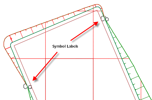

  12. Under Irregular Cell Label Options, you can specify settings that are used when the edge of the selected boundary causes a grid cell to have an irregular shape.
    Note: These options are used when a boundary is selected in the main dialog box.
    • Boundary Point: Specifies that when the shape of a grid cell is irregular, a symbol label is used, the original elevation labels are used, or no elevation labels are used.
      If you select Symbol Label, symbols are inserted at the locations where cells are irregular and information about those points is inserted into a table in the drawing.
