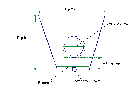

This subassembly creates a stone-filled drain structure with a circular pipe inside.
The attachment point for this subassembly can be at the bottom center, the top center, or the top corner of the drain structure.

| Parameter | Description | Type | Default |
| Side |
Specifes to insert the subassembly either on the right or the left side of the attachment point. |
Left / Right | Right |
| Attachment Point | Specifies location of subassembly attachment point. | String; (a) Top center; (b) Bottom center, (c) Top corner | Top corner |
| Bottom Width | Bottom Width of the trench | Numeric, Positive |
1.0 ft 0.3 m |
| Top Width | Top width of the trench | Numeric, Positive |
1.5 ft 0.5 m |
| Depth | Total depth of the trench | Numeric, Positive |
2.0 ft 0.6 m |
| Bedding Depth | Depth of the pipe bedding over trench bottom | Numeric, Positive |
0.6 ft 0.2 m |
| Pipe Diameter | Drain pipe diameter | Numeric, Positive |
0.6 ft 0.2 ft |
| Pipe Thickness | Thickness of the pipe material (optional) | Numeric, Positive |
0.0 ft 0.0 m |

The subassembly builds the shape for a simple drain structure as shown in the above illustration.
In layout mode, this subassembly draws as it is defined using the input parameters, starting from the attachment point.
