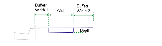

This subassembly is used to insert links defining a concrete sidewalk with optional boulevards.
The attachment point is at the inside edge of the inside buffer.
Note: All dimensions are in meters or feet unless otherwise noted. All slopes are in run-over-rise form (for example, 4 : 1) unless indicated as a percent slope with a “%” sign.

The links for the inside buffer zone, sidewalk, and outside buffer zone are inserted outward from the attachment point at a horizontal slope. The buffer zones may be omitted by setting their widths to zero.
In layout mode, this subassembly draws the buffer zone and sidewalk as specified by the input parameters.
