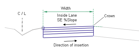

This subassembly creates a cross-sectional representation of a travel lane that is being inserted from the inside edge of pavement towards the crown point.
Note: This subassembly does not support superelevation axis of rotation pivot points other than Centers. This subassembly has been deprecated and is available only in the Corridor Modeling Catalogs. The LaneSuperelevationAOR subassembly has all the functionality of this subassembly, and it supports superelevation axis of rotation pivot points.
It uses the Outside Lane superelevation slope value for the corridor model’s baseline alignment. The pavement structure follows the standards described in “Pavement Structure on Paved Sections” in the AutoCAD Civil 3D Help.
The attachment point is at the inside edge of lane on the finish grade surface. This component can be attached to either the left or right side.

The Inside Lane superelevation slope is obtained from the superelevation specifications for the baseline alignment, and the algebraic sign of this value is reversed. If inserting to the left, the Right Outside Lane Slope is obtained and reversed; if inserting to the right, the Left Outside Lane Slope is obtained and reversed. Starting at the attachment point, a finish grade surface and parallel subgrade are inserted using the given width, depth, and the reverse superelevation slope. Vertical links close the shape at either end of the lane.
If an offset horizontal alignment name is assigned to the Width during corridor modeling, the width of the lane will vary to match the offset of the alignment.

In layout mode, this subassembly displays the finish, base, and subbase links for the given width and depths at a -2% slope.
