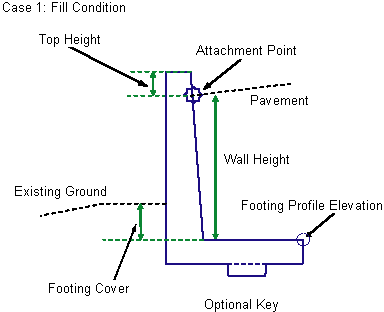

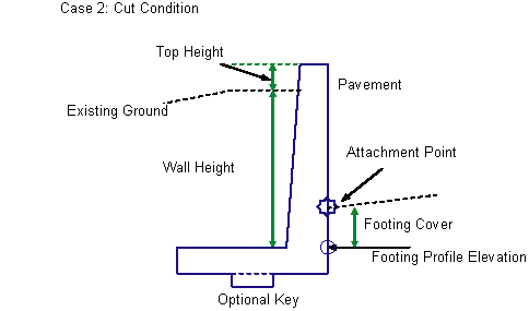

The attachment point varies depending on whether the retaining wall is in cut condition or fill. If it is in fill, the attachment point is near the top of the retaining wall. The attachment point is near the footing if it is inserted in cut condition.

| Top Height | The distance between the top-of-the wall and the hook in fill or the new hook in cut. | Numeric |
1.320 ft 0.40 m |
| Footing Cover | The depth of cover from the top-of-footing to the finish grade line on the back side of the wall in fill or to the hook when in cut. | Numeric |
1.667 ft 0.50 m |
| Key | Species to add an optional key below the footing | Boolean | Yes |
Wall height is determined from top of the footing to attachment point of ground elevation on the vertical face, whichever is higher. Wall battered slope, width of the footing, optional key dimensions, and the location of the key center, are all functions of the wall height.

This subassembly can be inserted on either left or right sides. The attachment point is different for the fill or cut condition. In fill, the attachment point is assumed to be where the finish grade intersects the inside face of the wall, below the top of the wall, at a distance equal to the Top Height parameter. In cut, the attachment point is assumed to be where the finish grade intersects the inside face, above the top-of-footing, at a distance equal to the Footing Cover parameter. The wall height is determined from the Wall Height or Profile input. In fill, the sloping wall face is toward the center of the roadway. In cut, the sloping wall face is away from the roadway, towards the earth being retained. If the Key option is set to No, then the base of the footing is a single horizontal link. If the Key option is used, links to define the optional key are inserted.
In layout mode, the subassembly draws the retaining wall shape as specified by the input parameter values, assuming that the subassembly is in a fill condition.

Fill Condition
Cut Condition
