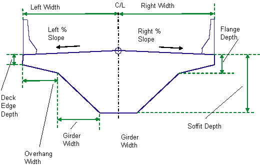

The attachment point is at the centerline on the bridge deck finish grade. The bridge section is built to the left and right sides.
Input Parameters
Note: All dimensions are in meters or feet unless otherwise noted. All slopes are in run-over-rise form (for example, 4 : 1) unless indicated as a percent slope with a “%” sign.
Parameter
Description
Type
Default
Left Width
Width of the left side of the bridge deck
Numeric, positive
5.34 m
17.8 ft
Right Width
Width of the right side of the bridge deck
Numeric, positive
5.34 m
17.8 ft
Left - Use Superelevation
Specifies to use superelevation slope on the left side of the bridge.
List of options: No, Inside Lane Slope, Outside Lane Slope
Outside Lane Slope
Default Left Slope
Specifies default slope for the left side of the bridge, if superelevation slope is not specified.
Numeric
-2.0%
Right - Use Superelevation
Specifies to use superelevation slope on the right side of the bridge.
Outside Lane Slope
Default Right Slope
Specifies default slope for the right side of the bridge, if superelevation slope is not specified.
Numeric
-2.0%
Soffit Depth
Vertical distance from the edge of bridge deck to the soffit
Numeric, positive
2.0 m
6.67 ft
Edge Depth
Thickness of the bridge deck at the edge
Numeric, positive
0.150 m
0.5 ft
Flange Depth
Vertical distance from the edge of bridge deck to the root of the flange
Numeric, positive
0.300 m
1.0 ft
Overhang Width
Width of the overhang
Numeric, positive
1.2 m
4.0 ft
Girder Width
Width of the girder
Numeric, positive
2.0 m
6.67 ft

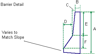

Include Barriers
Omit Barriers
Includes or omits barriers to each side of the bridge deck.
Include / Omit
Include
Barrier A (mm or inches)
Height of the barrier at the center of median
Numeric, positive
810 mm
32 in
Barrier B (mm or inches)
As shown in diagram
Numeric, positive
131 mm
4.5 in
Barrier C (mm or inches)
As shown in diagram
Numeric, positive
59 mm
2 in
Barrier D (mm or inches)
As shown in diagram
Numeric, positive
125 mm
5 in
Barrier E (mm or inches)
As shown in diagram
Numeric, positive
557 mm
22 in
Barrier F (mm or inches)
As shown in diagram
Numeric, positive
178 mm
7 in

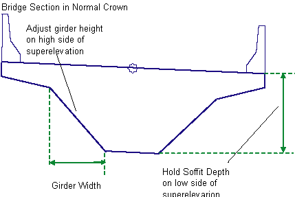

The subassembly builds the links for the bridge deck and under-structure based on the input parameter values given. In superelevation, not all of the structure is rotated. The Soffit Depth is held to the given value from the top-edge-of-deck on the low side of the bridge, and the height of the girder is adjusted on the high side to the root of the deck.
If Include Barriers is True, New Jersey barrier sections are added at the left and right edges-of-deck. The slopes of the barrier bottoms adjust to match the deck slopes.
