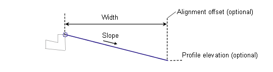

This subassembly is a general purpose utility to add a surface link by specifying its width and slope.
Either a % slope or ratio slope value may be given. An alignment or profile can be used when building a corridor model to allow variable width and slope.
The attachment point is at the inside edge of the link. This subassembly can be inserted in the left or right direction from the attachment point.
Note: All dimensions are in meters or feet unless otherwise noted. All slopes are in run-over-rise form (for example, 4 : 1) unless indicated as a percent slope with a “%” sign.

Width |
Width of the lane from the offset of the inside edge to the offset of the outside edge |
Numeric, positive |
3.0 10.0 ft |

Slope |
% slope of the link. Negative slopes go downward in the direction inserted. |
Numeric |
2 (%), (or 2:1) |

Width |
May be used to override the fixed link Width and tie the end-of-link to an offset alignment. The following object types can be used as targets for specifying this offset: alignments, polylines, feature lines, or survey figures. |
Optional |
%Slope |
May be used to override the fixed % Slope and tie the end-of-link to a profile. The following object types can be used as targets for specifying this: profiles, 3D polylines, feature lines, or survey figures. |
Optional |

The link is added in the direction of insertion starting at the attachment point and going the given width and slope. If an offset horizontal alignment name is assigned to the Width during corridor modeling, the width of the lane will vary to match the offset of the alignment. If a profile name is assigned to the Slope, the slope is adjusted to match the profile elevation at the end of the link.
