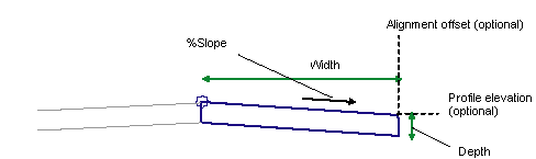

This subassembly creates a simple lane with finish grade and subbase, where the edge-of-traveled-way can be tied to an alignment or profile.
The attachment point is either (a) at the inside edge of lane on finished grade, if the insertion point is Crown, or (b) at the outside edge of travel way, if the insertion point is at the edge of travel way.

Width |
Width of lane |
Numeric, positive |
3.6 m 12.0 ft |
Depth |
Depth from finish grade to subbase |
Numeric, positive |
0.2 m 0.67 ft |
%Slope |
% Slope of the lane |
