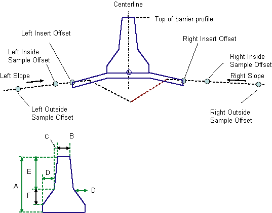

This subassembly widens an existing divided highway by extending from the travel lane edges inward over a depressed median, with a symmetrical barrier at the centerline. The median slopes may vary somewhat from the existing slopes to make both sides meet at the centerline, or to hold the top of the barrier to a profile.
The attachment point is at the midpoint of the base of the barrier.
Note: All dimensions are in meters or feet unless otherwise noted. All slopes are in run-over-rise form (for example, 4 : 1) unless indicated as a percent slope with a “%” sign.

The left and right slopes are calculated between the sample points on each side.
If the Top of Barrier Profile is not given:
If a Top of Barrier Profile is given as a target parameter:
None.
In layout mode, a median and barrier are drawn with the fixed dimensions as shown in the following diagram. This is the same figure that is drawn in layout mode for the OverlayMedianAsymmetrical subassembly.
