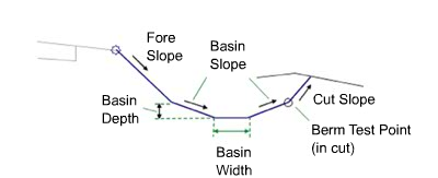

This subassembly is similar to the DaylightBasin subassembly with the following additional behaviors:

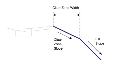

The berm is optional in fill conditions. If no berm is included, a clear zone slope is added, and then a daylight fill slope is added.
The Ditch Width can be controlled by using an optional alignment. Berm Width and Height can be controlled by using an alignment and a profile respectively. In addition, the Place Lined Material needs to include all links of the daylight assemblies from the hinge point out to the daylight to existing ground.
The attachment point is at the inside edge of the basin foreslope. This component can be attached to either the left or right side.

This subassembly builds the links for the basin foreslope and the basin out to the basin test point. If a profile is given, the width of the foreslope varies to hold to the basin profile. If the basin test point is in cut, the daylight intercept is calculated on the target surface at the given cut slope.
If it is in fill, and Berm is set to Include, a top-of-berm link is added, and the daylight intercept is calculated on the target surface at the given Fill Slope. The daylight link is not inserted if Omit Daylight Link is set to True. If the top-of-berm link intersects the target surface, the section is terminated at the intersection.
If it is in fill, and Berm is set to Omit, a link is added from the attachment point at the Clear Zone Slope until the Clear Zone Width is met. Then a daylight link is added to the target surface at the fill slope specified. If the clear zone link intersects existing ground, it will stop at this intersection point.
