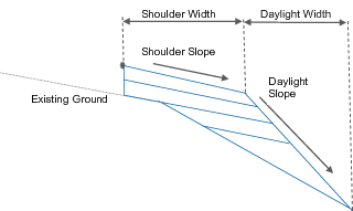

This subassembly inserts a shoulder for widening situations that will trim the base and subbase layers based on the location of the existing ground surface.
The attachment point is at the inside edge of the shoulder on the finish grade surface.

When inserted, this subassembly checks for the presence of the target existing ground surface. If this surface exists, then the base and subbase surfaces will be trimmed to the existing ground.
If the surface does not exist, then this shoulder behaves the same as the ShoulderExtendAll subassembly.
In layout mode, this subassembly displays the links defined by the input parameters.
