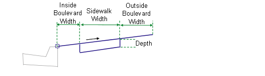

This subassembly inserts links for a concrete sidewalk with inside and outside grass boulevards.
The attachment point is at the inside edge of the inside boulevard. The UrbanSidewalk subassembly is typically attached to a back-of-curb or edge of pavement.

Inside Boulevard Width |
Width of the inside grass boulevard |
Numeric, positive |
0.0 |
Sidewalk Width |
Width of the concrete sidewalk |
Numeric, positive, non-zero |
1.5 m 5.0 ft |
Outside Boulevard Width |
Width of the outside grass boulevard |
Numeric, positive |
0.0 |
%Slope |
% slope of the sidewalk and grass strips. Positive slopes are upwards from the attachment point. |
Numeric |
2 (%) |
Depth |
Depth of concrete for the sidewalk |
Numeric, positive |
0.100 m 0.333 ft |
The inside grass strip, sidewalk, and outside grass boulevard links are inserted outward from the attachment point at the given slope. The grass strips can be omitted by specifying a zero-width.
