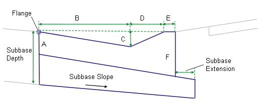

This subassembly inserts links for a slope-bottomed valley curb and gutter with subbase.
User-defined input parameters control the dimensions of the shape.

Dimension A
Depth of the gutter at the flange point
Numeric, positive,
non-zero
150 mm
6 in
Dimension B
Width from the gutter flange point to the gutter flowline
Numeric, positive,
non-zero
610 mm
24 in
Dimension C
Depth from the gutter flange point to the gutter flowline, and from the gutter flowline to the top-of-curb
Numeric, positive,
non-zero
100 mm
4 in
Dimension D
Width from the gutter flowline to the top-of-curb
Numeric, positive,
non-zero
225 mm
9 in
Dimension E
Width from the top-of-curb to back-of-curb
Numeric, positive,
non-zero
75 mm
3 in
Dimension F
Height of the back-of-curb
Numeric, positive,
non-zero
300 mm
12 in
Behavior
The curb and gutter links are inserted based on the Input Parameter dimensions Dimension A – Dimension F. All dimensions must be positive, non-zero values. If a non-zero subbase depth is given, the subbase layer is inserted to the back of curb, and continues for the Subbase Extension width. The subbase layer closes to the bottom-back-of-curb, as shown in the diagram.
