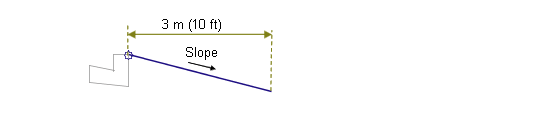

This subassembly is a general purpose utility to extend a link at a given slope until it reaches a defined elevation or profile.
The attachment point is at the inside edge of the link. This subassembly can be inserted in the left or right direction from the attachment point.

A link is added from the attachment point in the direction of insertion for the given slope until it reaches the target elevation or profile. The slope value is applied upward if the target elevation is above the attachment point, otherwise a negative slope is used.
This subassembly includes an optional input parameter named Use Superelevation Slope that lets you specify to use the superelevation slope for the shoulder. This parameter can be set to a) Outside shoulder slope, b) Inside shoulder slope, c)Outside Lane, d)Inside Lane, or e) None. None is the default setting.
