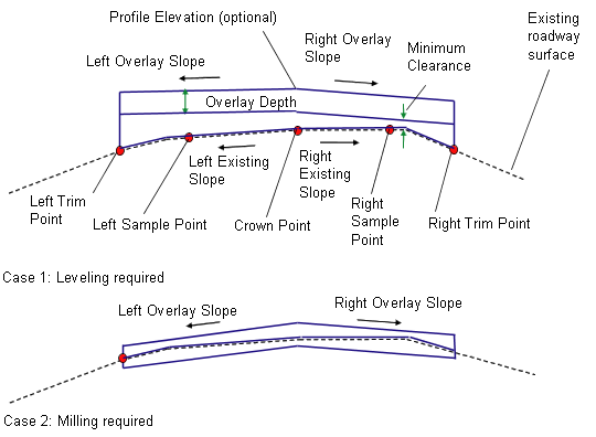

This subassembly adds an overlay layer on an existing crowned roadway, with either a leveling and milling layer added as required.
The attachment point is the crown point on the overlay finish grade.

%Slope Tolerance |
The value that the Overlay Slopes are allowed vary from their design values. The slope tolerance is not used if the Overlay Slope is given as M (see Behavior below for details). |
Numeric, positive |
0.5% |
Use Profile |
Selects whether to hold the top of overlay at the inside trim point to the corridor profile elevation, or to set the vertical placement of the overlay layer based on the Minimum Clearance value |
Selection List |
Use minimum clearance |

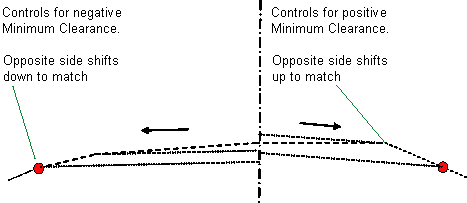

Minimum Clearance (+/-) |
The minimum vertical clearance between the existing surface and the bottom of the overlay layer. A positive value places the bottom-of-overlay link above the existing surface, creating a Leveling layer beneath the overlay. A negative value places the bottom-of-overlay link below the existing surface, creating a Milling layer that coincides with a portion of the Overlay layer. |
Numeric |
0.100 m 0.30 ft |
Overlay Depth |
The thickness of the overlay layer |
Numeric, positive |
0.100 m 0.30 ft |

This subassembly inserts parallel links defining the top and bottom of an overlay layer on each side that join at the crown point. The links are inserted from the Crown Point Offset to the Left and Right Trim Offsets.
Overlay Slopes
The slope of the Existing Surface on each side is determined betweenthe crown and sample points. The slopes of the overlay layers aredetermined by the following steps:
Overlay Elevations
The elevations of the overlay points are determined as follows:
Minimum Clearance Point
The method of determining the point where the Minimum Clearance applies is shown in the diagram below.

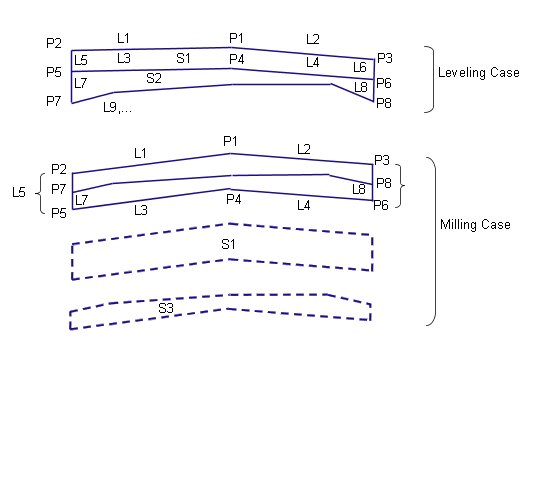

The following table lists the point, link, and shape codes for this subassembly that have codes assigned to them. Point, link, or shape codes for this subassembly that do not have codes assigned are not included in this table.
Point, Link, or Shape |
Code |
Description |
P1 |
Crown |
Crown on finish grade |
P2, P3 |
EOV |
Overlay edges on finish grade |
P4 |
Crown_Overlay |
Crown on bottom-of-overlay |
P5, P6 |
EOV_Overlay |
Edges of bottom-of-overlay |
L1, L2 |
Top, Pave |
Top of overlay |
L3 – L6 |
Overlay |
Overlay links. Note that L5, L6 go from the bottom-of-overlay to top-of-overlay in both the Leveling and Milling cases. |
L7, L8 |
Level Mill |
Verticals from existing surface to bottom-of-overlay: Level - For the Leveling case. Mill - For the Milling case. |
S1 |
Overlay |
Area between the top and bottom of overlay. This overlaps the milling area (S3) for the Milling case as shown below. |
S2 |
Level |
Area above existing surface and below the bottom of overlay (Leveling case) |
S3 |
Mill |
Area below the existing surface and above the bottom of overlay (Milling case). This area overlaps the Overlay area as shown below. |
