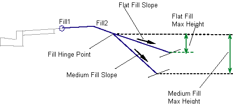

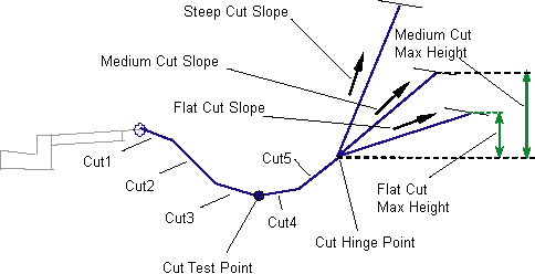

Flat Cut Slope |
First, flattest, catch slope to attempt. |
Numeric, positive |
6 ( : 1) |
Flat Cut Max Height |
Maximum allowable height of the closing link using the Flat Cut Slope |
Numeric, positive |
1.5 m 5 ft |
Medium Cut Slope |
Cut slope to attempt if the Flat Cut Slope link exceeds the Flat Cut Max Height |
Numeric, positive |
4 ( : 1) |
Medium Cut Max Height |
Maximum allowable height of the closing link using the Medium Cut Slope. |
Numeric, positive |
3 m 10 ft |
Steep Cut Slope |
Cut slope to use if the Medium Cut Slope link exceeds the Medium Cut Max Height. |
Numeric, positive |
2 ( : 1) |

Flat Fill Slope |
First, flattest, catch slope to attempt. (x : 1) |
Numeric, positive |
6 ( : 1) |
Flat Fill Max Height |
Maximum allowable height of the closing link using the Flat Fill Slope |
Numeric, positive |
1.5 m 5 ft |
Medium Fill Slope |
Fill slope to attempt if the Flat Fill Slope link exceeds the Flat Fill Max Height |
Numeric, positive |
4 ( : 1) |
Medium Fill Max Height |
Maximum allowable height of the closing link using the Medium Fill Slope |
Numeric, positive |
3 m 10 ft |
Steep Fill Slope |
Fill slope to use if the Medium Fill Slope link exceeds the Medium Fill Max Height |
Numeric, positive |
2 ( : 1) |

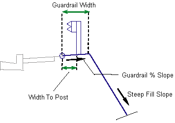

Guardrail Width |
Width of the guardrail widening link for fill slopes using Steep Fill Slope. Use zero for no guardrail widening. |
Numeric, positive |
0.6 m 2 ft |
Guardrail %Slope |
% slope of the guardrail widening link |
Numeric |
-2 (%) |
Include Guardrail Omit Guardrail |
Include to insert links for the guardrail structure on the guardrail widening segment. Omit does not insert the guardrail structure. |
Include / Omit |
Omit |

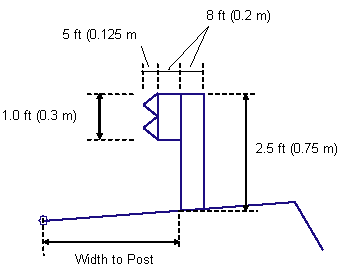

Width to Post |
When the guardrail is included, the width from the attachment point to the inside edge of the guardrail post. |
Numeric |
0.3 m 1 ft |

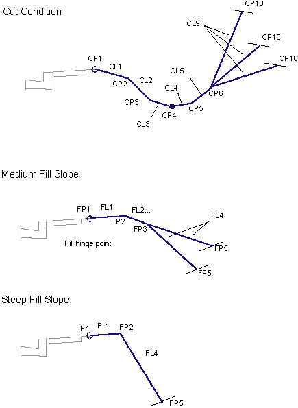

This subassembly is designed to accommodate a wide variety of clear zone, cut section, and fill section configurations. It allows up to eight links to be used in cut sections from the edge-of-roadway to the cut intercept hinge point, and any one of these links can be used as the cut test point. Up to three fill links can be used out to the fill hinge point, and provides special guardrail shoulder widening for steep fill conditions.
Cut links are denoted as Cut 1, Cut 2, up to Cut 8. The Cut Test Point input value indicates which cut link ends at the cut test point. The logical steps used are as follows:
The cut example in the subassembly diagram show where five Cut links are defined. The cut test point is on the third link. The fill example shows two defined Fill links.

A guardrail structure may be applied to fill sections that meet the criteria for using the steep fill slope. If this criteria is met, the Guardrail Width is not zero, and Include Guardrail is set to true, then a guardrail structure is drawn at the station. The dimensions of the guardrail structure are fixed as shown in the diagram below.
