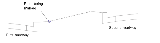

In the example below, there are two roadways with independent profiles. Once the links for the first roadway are created, the point at the left outside edge is being marked. Later, after the links for the second roadway are created, a link can be inserted from its right outside edge back to the marked point.
