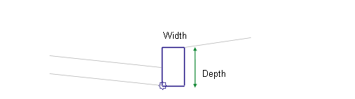

This subassembly creates a a simple curb at the edge of roadway. It can be attached to either outside edge of pavement or to the edge of a median on the inside.
The attachment point is on the front face of the curb for case 1, and on the back face of the curb for case 2.

Width |
Width of curb |
Numeric, positive |
0.225 m 0.75 ft |
Depth |
Depth of the curb |
Numeric, positive |
0.45 m 1.5 ft |

The subassembly builds a rectangular shape for a simple curb, with the attachment point at the bottom inside edge of curb.
In layout mode, this subassembly draws the curb shape as specified by the input parameters.
