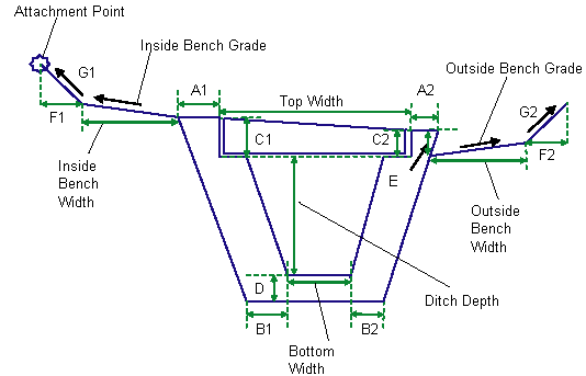

This subassembly creates a ditch structure to add to either the left or the right sides of the assembly.
Optionally, this subassembly can add daylight links on either side of the structure.
The attachment point is at the innermost point on the grading links preceding the ditch structure. If the grading links on the inside are omitted, then the attachment point is on the innermost point of the inside wall.

The subassembly builds the shape for a ditch structure, as shown in the above illustration. To omit the daylight and bench links, enter a zero value for the appropriate width parameters.
In layout mode, this subassembly draws as it is defined using the input parameters, starting from the attachment point.
