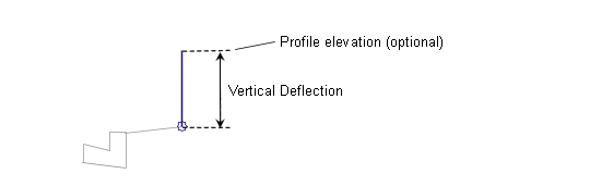

This subassembly is a general purpose utility to add a vertical surface link by vertical deflection.
A profile can be used when building a corridor model to allow variable vertical deflection.
The attachment point is at the inside edge of the link. This subassembly can be inserted in the left or right direction from the attachment point.
Note: All dimensions are in meters or feet unless otherwise noted. All slopes are in run-over-rise form (for example, 4 : 1) unless indicated as a percent slope with a “%” sign.

A vertical link is added from the attachment point for the given vertical deflection. If a profile name is given for the Vertical Deflection, the end of the link will match the profile elevation.
In layout mode, this subassembly displays the link for the given +/- vertical deflection.
