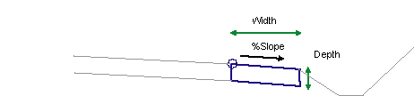

The shoulder links are inserted outwards from the attachment point at the given width, slope, and depth.

Coding Diagram
