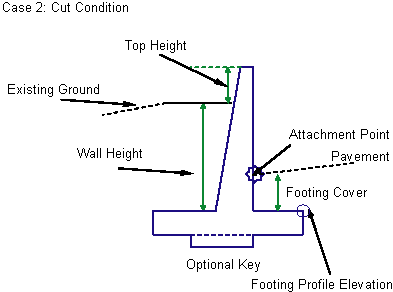

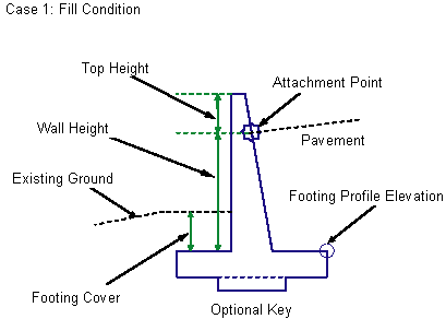

This subassembly inserts a retaining wall structure with one tapered side and an optional key at the bottom.
The attachment point varies depending on whether the retaining wall is in cut condition or fill. If it is in fill, the attachment point is near the top of the retaining wall. If it is inserted in cut condition, the attachment point is near the footing.
Note: All dimensions are in meters or feet unless otherwise noted. All slopes are in run-over-rise form (for example, 4 : 1), unless indicated as a percent slope with a “%” sign.

Wall height is determined from the top of the footing to the insertion point of the ground elevation on the vertical face, whichever is higher. Wall battered slope, width of the footing, offset of wall vertical face, optional key dimensions, and the location of the key center, are all functions of the wall height.

This subassembly can be inserted on either the left or the right sides. The attachment point is different for the fill or cut condition. In fill, the attachment point is assumed to be where the finish grade intersects the inside face of the wall, at a distance of Top Height below the top of the wall. In cut, the attachment point is assumed to be where the finish grade intersects the inside face, at a distance of Footing Cover above the top-of-footing. The wall height is determined from the Wall Height or Profile input.
In fill, the sloping wall face is toward the center of the roadway. In cut, the sloping wall face is away from the roadway. If the Key option is set to No, then the base of the footing is a single horizontal link. If the Key option is used, links to define the optional Key are inserted.

Fill Condition
Cut Condition
