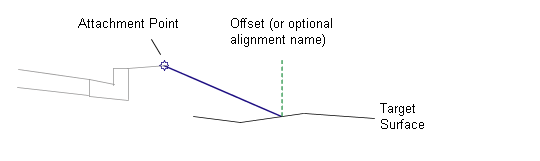

This subassembly is a general purpose utility to extend a link from the attachment point to a given offset on a target surface.
An alignment can be used when building a corridor model to calculate the offset.
The attachment point is at the beginning of the link.

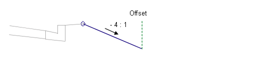

A link is extended to the point on the target surface at the given offset.
In layout mode, this subassembly displays the link drawn to the given offset at a -4 : 1 slope. The link terminates with an arrowhead pointing outwards.
