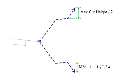

In layout mode, this subassembly draws the initial cut and fill slopes to their maximum heights, a single bench, followed by cut and fill daylight slopes for half the maximum heights. The daylight links terminate with an arrowhead pointing outwards.
