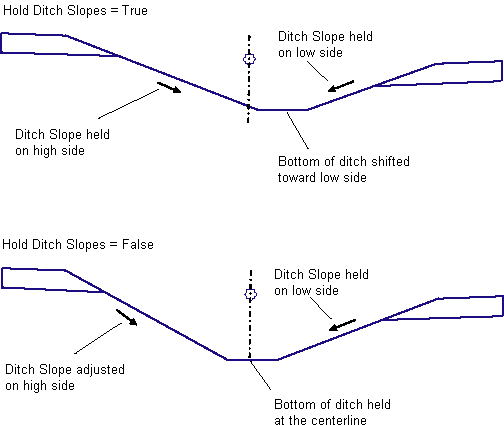

Ditch Elevations and Slopes
Superelevation or turning lanes may cause the top of the ditch slopes to be at different elevations on the left and right sides, resulting in an asymmetrical ditch. There are two options for handling this situation. If Hold Ditch Slopes is set to True, then the given ditch slopes are held constant on both sides, which shifts the bottom of ditch away from the centerline towards the lower side. If set to False, the ditch bottom is centered about the median centerline, the given slope is held on the lower side, and the slope is adjusted to match on the higher side.

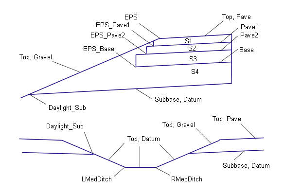

The following table lists the point, link, and shape codes for this subassembly that have codes assigned to them. Point, link, or shape codes for this subassembly that do not have codes assigned are not included in this table.
Point, Link, or Shape |
Code |
Description |
Points |
As shown below |
Links |
As shown below |
S1 |
Pave1 |
S2 |
Pave2 |
S3 |
Base |
S4 |
SubBase |
