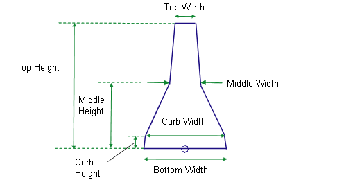

This subassembly creates a two-sided New Jersey barrier on a roadway surface.
This subassembly is one of a group of Getting Started subassemblies used for simple roadway modeling, and for tutorial and training purposes.
The attachment point is at the center of the bottom of the barrier.
Input Parameters
Note: All dimensions are in meters or feet unless otherwise noted. All slopes are in run-over-rise form (for example, 4 : 1) unless indicated as a percent slope with a “%” sign.
Parameter
Description
Type
Default
Top Width
Width of the top of the barrier
Numeric, positive
0.15 m
0.5 ft
Middle Width
Width of the middle of the barrier
Numeric, positive
0.225 m
0.75 ft
Bottom Width
Width of the bottom of the barrier
Numeric, positive
0.6 m
2.0 ft
Top Height
Height to the top of the barrier
Numeric, positive
0.9 m
3.0 ft
Middle Height
Height to the middle of the barrier
Numeric, positive
0.45 m
1.5 ft
Curb Height
Height of the barrier curb
Numeric, positive
0.075 m
0.25 ft
Curb Width
Width at the top of the barrier curb
Numeric, positive
0.6 m
1.9 ft
Output Parameters
None.
Target Parameters
This section lists the parameters in this subassembly that can be mapped to one or more target objects. For more information, see in the AutoCAD Civil 3D User’s Guide Help.
Target Parameters: None.
Behavior
The subassembly constructs the shape of a two-sided New Jersey barrier, with the base centered about the attachment point.
Layout Mode Operation
In layout mode, this subassembly draws the barrier shape as specified by the input parameters.

Coding Diagram
