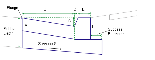

This subassembly inserts links for a slope-bottomed valley curb and gutter with subbase.
The bottom surface of the curve flattens to a horizontal link at the gutter flowline. User-defined input parameters control the dimensions of the shape.
The attachment point is at the flange point of the gutter or the back of the curb.
Note: Subbase dimensions are in meters or feet. Curb-and-gutter dimensions must be given in millimeters or inches.
Parameter |
Description |
Type |
Default |
Side |
Specifes to insert the subassembly either on the right or the left side of the attachment point. |
Left/Right |
Right |
Insertion Point |
Specifies insertion point of the curb and gutter as either Gutter Edge or Back of Curb |
Boolean |
Gutter Edge |
Gutter Slope Method |
Specifies method of gutter slope input |
Selection list |
Outside Lane Slope |
Gutter Slope |
Specifies fixed gutter slope |
Numeric |
- 2% |
| Gutter Slope Direction | Specifies whether the gutter slopes towards the crown or away from the crown | Selection list | Away from Crown |
Subbase Depth |
Depth to subbase at the flange point. Use zero if there is no subbase. |
Numeric, positive |
1.0 m 1.5 ft |
Subbase Extension |
Distance the subbase is extended beyond the back-of-curb. Use zero to terminate the subbase at the back-of-curb. |
Numeric, positive |
0.3 m 1 ft |
Subbase Slope Method |
Selects whether to use the Outside Lane superelevation slope for the subbase layer, or to set a numeric % slope value |
Selection list |
Subbase Slope |
Cross slope of the subbase layer. Not used if Use SE is set to True. |
Numeric |
- 2 (%) |
Dimension A |
Depth of the gutter at the flange point |
Numeric, positive, non-zero |
150 mm 6 in |
Dimension B |
Width from the gutter flange point to the gutter flowline |
600 mm 24 in |
Dimension C |
Depth from the gutter flange point to the gutter flowline, and from the gutter flowline to the top-of-curb |
50 mm 2 in |
Dimension D |
Width from the gutter flowline to the top-of-curb |
40 mm 1.5 in |
Dimension E |
Width from the top-of-curb to back-of-curb |
150 mm 6 in |
Dimension F |
Height of the back-of-curb |
300 mm 12 in |
The curb and gutter links are inserted based on the Input Parameter values for Dimension A – Dimension F. All dimensions must be positive, non-zero values. If a non-zero subbase depth is given, the subbase layer is inserted to the back of curb, and continues for the Subbase Extension width. The subbase layer closes to the bottom-back-of-curb, as shown in the diagram.
The subassembly builds the shape for a simple curb and gutter, with the attachment point either at (a) inside edge of the gutter (or lip), or (b) the back of the curb. The face of the curb is given a small, constant width to make it non-vertical.
