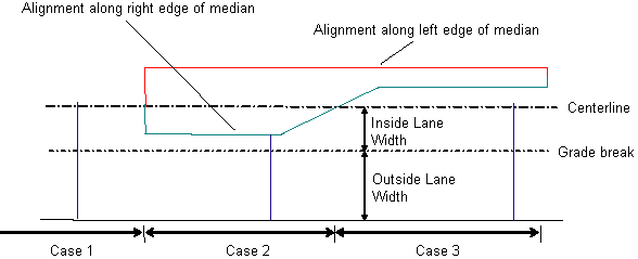

This subassembly inserts one or more travel lanes outward from an alignment that defines the edge of a median.
The alignment defining the edge of the median may at times be either not present (Case 1), outside the roadway centerline (Case 2), or inside the centerline (Case 3).
To use this subassembly, you should have separate alignments defining the left and right edges of the median. It may be necessary to define separate corridor model regions for each individual median. This subassembly differs from LaneFromTaperedMedian1 in that it provides for a grade break with different slopes in the travel lanes.
The attachment point is at the location where the inside edge-of-traveled-way would be if there was no median. This is typically at the assembly baseline.

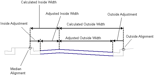

Inside Adjustment |
Used if the Median Edge alignment is at a fixed offset from the actual edge-of-traveled-way (for example, at the back of curb). Adjusts the calculated Inside Lane Width to account for the offset (see diagram). |
Numeric, positive |
0.0 |
Outside Adjustment |
Used if the Outside Lane Width alignment is at a fixed offset from the actual edge-of-traveled-way (for example, at the back of curb). Adjusts the calculated Outside Lane Width to account for the offset (see diagram). |
Numeric, positive |
0.0 |

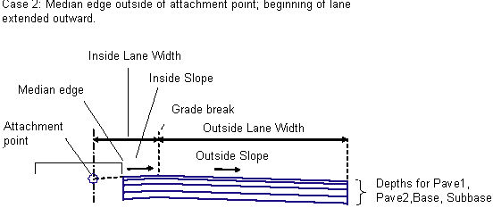

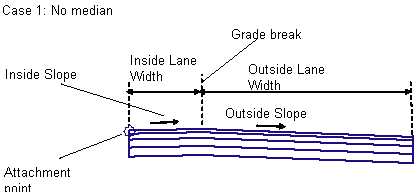

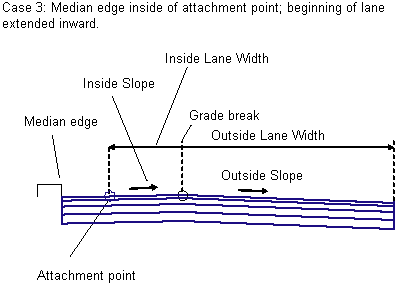

Inside Edge-of-Traveled-Way: The location of the inside edge-of-traveled-way is calculated based on the three cases shown in the previous diagram. If a Median Edge alignment is given, and that alignment is outside of the lane’s attachment point, the inside edge is shifted outward from the attachment point at the lane slope (Case 2). If the Median Edge alignment is inside of the lane’s attachment point, the inside edge is shifted inward from the attachment point at the inside lane slope (Case 3). If no Median Edge alignment is given, or the given one is not found at a station, the inside edge is held at the attachment point (Case 1).
Inside and Outside Adjustments: The Inside Adjustment and Outside Adjustment parameters are provided in case the alignments used for the inside or outside edges are at a fixed offset from the actual edge-of-traveled-way. For example, the alignment being used for the Median Edge may be at the back-of-curb instead of at the pavement edge. In this case, the Inside Adjustment parameter should be set to the width of the curb.

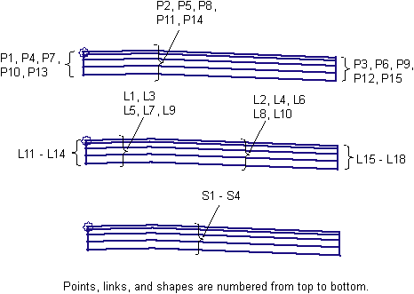

P1, P3 |
ETW |
Edges of lane on finish grade |
P4, P6 |
ETW_Pave1 |
Edges of lane on Pave1 layer |
P7, P9 |
ETW_Pave2 |
Edges of lane on Pave2 layer |
P10, P12 |
ETW_Base |
Edges of lane on Base layer |
P13, P15 |
ETW _Sub |
Edges of lane on Subbase layer |
P2 |
Crown |
Crown (grade break) on finish grade |
P5 |
Crown_Pave1 |
Crown (grade break) on Pave1 |
P8 |
Crown_Pave2 |
Crown (grade break) on Pave2 |
P11 |
Crown_Base |
Crown (grade break) on Base |
P14 |
Crown_Subbase |
Crown (grade break) on Subbase |
L1, L2 |
Top, Pave |
Finish grade surface |
L3, L4 |
Pave1 |
Pave1 surface |
L5, L6 |
Pave2 |
Pave2 surface |
L7, L8 |
Base |
Base surface |
L9, L10 |
SubBase, Datum |
Subbase surface |
S1 |
Pave1 |
Area between finish grade and Pave1 |
S2 |
Pave2 |
Area between Pave1 and Pave2 |
S3 |
Base |
Area between Pave2 and Base |
S4 |
SubBase |
Area between Base and Subbase |
