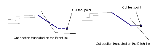

This subassembly creates corridor-side daylighting links with user-defined slope configurations, such as flat, medium, and maximum slopes for cut and fill situations.
This subassembly creates either a v-shaped or flat- bottom ditch in cut situations, and includes an option to include guardrail widening for steep fill conditions.
The final daylighting link can be omitted for cases where the corridor model needs to be left in an incomplete state. For example, this might be done so that grading surfaces on adjacent properties can tie to the hinge point on the uncompleted roadway.

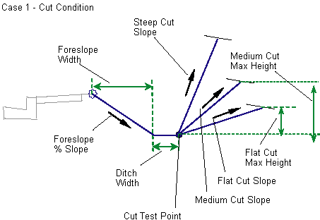

Flat Cut Slope |
First, flattest, catch slope to attempt. (x : 1) |
Numeric, positive |
6 ( : 1) |
Flat Cut Max Height |
Maximum allowable height of the closing link using the Flat Cut Slope |
Numeric |
1.5 m 5 ft |
Medium Cut Slope |
Cut slope to attempt if the Flat Cut Slope link exceeds the Flat Cut Max Height |
Numeric, positive |
4 ( : 1) |
Medium Cut Max Height |
Maximum allowable height of the closing link using the Medium Cut Slope |
Numeric |
3 m 10 ft |
Steep Cut Slope |
Cut slope to use if the Medium Cut Slope link exceeds the Medium Cut Max Height |
Numeric, positive |
2 ( : 1) |

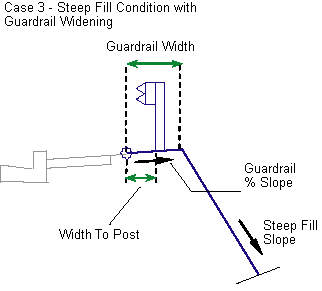

Guardrail Width |
Width of the guardrail widening link for fill slopes using Steep Fill Slope. Use zero for no guardrail widening. |
Numeric, positive |
0.6 m 2 ft |
Guardrail %Slope |
% slope of the guardrail widening link |
Numeric |
-2 (%) |
Include Guardrail Omit Guardrail |
Include to insert the guardrail structure when guardrail widening occurs. Omit does not insert the guardrail structure. |
Include / Omit |
Omit |
Width to Post |
When the guardrail is included, the width from the attachment point to the inside edge of the guardrail post. |
Numeric |
0.3 m 1 ft |

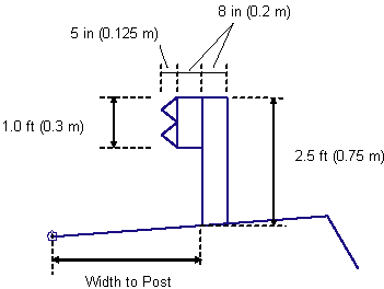

A guardrail structure may be applied to fill sections that meet the criteria for using the steep fill slope. If this criteria is met, the Guardrail Width is not zero, and Include Guardrail is set to true, then a guardrail structure is drawn at the station. The dimensions of the guardrail structure are fixed as shown in the diagram below.

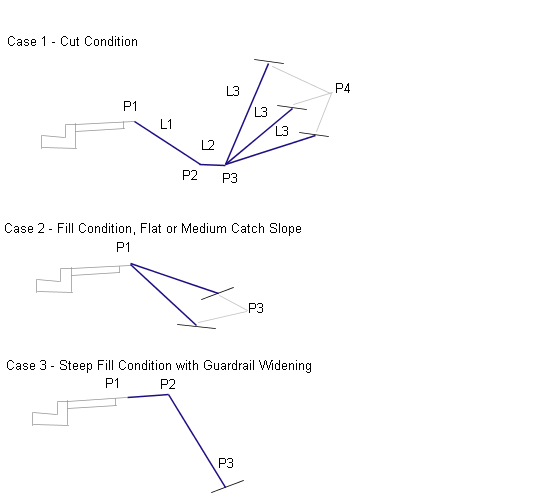

The following table lists the point, link, and shape codes for this subassembly that have codes assigned to them. Point, link, or shape codes for this subassembly that do not have codes assigned are not included in this table.
Point, Link, or Shape |
Code |
Description |
P1 |
Hinge Hinge_Fill |
Hinge point for the normal fill condition |
P2 |
Hinge Hinge_Fill |
Hinge point for the fill condition with guardrail widening |
P2 |
Ditch_In |
Inside edge of the bottom of the ditch (cut condition only) |
P3 |
Ditch_Out Hinge Hinge_Cut |
Outside edge of the bottom of the ditch (cut condition only) |
P3 |
Daylight Daylight_Fill |
Fill slope stake point (fill condition only) |
P4 |
Daylight Daylight_Cut |
Cut slope stake point (cut condition only) |
All Links |
Top Datum |
All links added by this subassembly, except for the guardrail structure links. |
Guardrail points |
None |
No codes are assigned to the points on the guardrail structure, if included. |
Guardrail links |
Guardrail |
All links comprising the guardrail structure, if included. |
L3 |
Top Datum Daylight Daylight_Cut |
Daylight link for cut section |
Fill Daylight Link |
Top Datum Daylight Daylight_Fill |
Daylight link for fill section |
