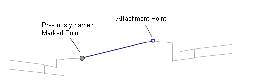

This subassembly is a general purpose utility that is similar to the LinkToMarkedPoint subassembly, and connects a link from the attachment point to a previously named marked point.
It can be used in a variety of situations, including connecting between adjacent roadways, where the relative offsets and elevations vary, or across a gore area between converging roadways. Use the MarkPoint subassembly if the connecting point has not already been named.
The primary difference between the LinkToMarkedPoint2 subassembly and the LinkToMarked point subassembly is in its application, when the marked point is on a different assembly baseline comparing to the link. Particularly if the two baselines in are not parallel, then the subassembly’s application will not be in the same plane, making the length of the link to marked point longer than it should be.
The attachment point is at the beginning of the link. The link may go in any direction. The direction is determined by the location of the marked point relative to the attachment point.

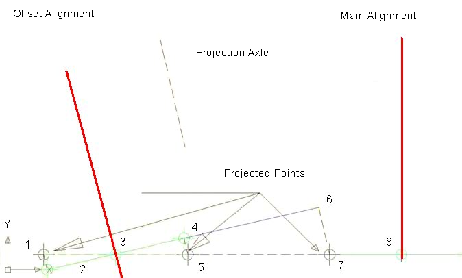

The following diagram illustrates how the LinkToMarkedPoint2 subassembly functions, as well as how it displays in a cross-section for the offset baseline portion of the corridor.
The LinkToMarkedPoint2 subassembly does either of the following, both of which have the same result:
Note that the new LinkToMarkedPoint2 subassembly should not rely on the fact that point #7 will be at a constant offset at all stations along the main alignment.
Note the following:
Note that using this approach, a lane subassembly on the offset portion of the corridor that is defined to be 3.5 meters in width, will be slightly wider than 3.5 meters in width when shown in the corridor cross-section.
In layout mode, this subassembly displays the link between the attachment point and the marked point.
