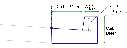

This subassembly creates a a simple curb and gutter structure at the inside or outside edges of roadway.
The attachment point is at the flange point of the gutter or back of the curb.
Note: All dimensions are in meters or feet unless otherwise noted. All slopes are in run-over-rise form (for example, 4 : 1) unless indicated as a percent slope with a “%” sign.
Parameter |
Description |
Type |
Default |
Side |
Specifies which side to place the subassembly |
Left / Right |
Right |
Insertion Point |
Specifies insertion point of the curb and gutter as either Gutter Edge or Back of Curb |
Boolean |
Gutter Edge |
Gutter Width |
Width from the flange of the gutter to the flowline |
Numeric, positive |
0.45 m 1.5 ft |
Gutter %Slope |
% slope of the gutter |
Numeric |
-6% |
Curb Height |
Height from the flowline to the top of curb |
Numeric, positive |
0.225 m 0.75 ft |
Curb Width |
Width of the top of curb |
Numeric, positive |
0.15 m 0.5 ft |
Curb Depth |
Depth from the top of curb to the bottom of curb at the back-of-curb point |
Numeric, positive |
0.45 m 1.5 ft |
