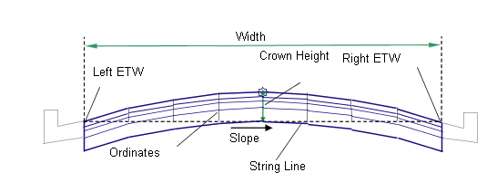

This subassembly creates a cross-sectional representation of finish grade, pavement, and subbase for urban, parabolic lanes between the left and right edges of traveled way.
The parabolic shape is simulated by a series of short, straight-line links. No superelevation is applied to the travel lanes. The pavement structure follows the standards described in “Pavement Structure on Paved Sections” in the AutoCAD Civil 3D Help.
The attachment point is at the crown of road on the finish grade surface. This component is symmetrical about the attachment point.
Note: All dimensions are in meters or feet unless otherwise noted. All slopes are in run-over-rise form (for example, 4 : 1) unless indicated as a percent slope with a “%” sign.

Crown Height |
Height from the center point of the string line to the crown of road |
Numeric, positive |
0.10 m 0.3333 ft. |
Width |
Width of the roadway from the left edge-of-traveled-way to the right edge-of-traveled-way |
Numeric, positive |
7.2 m 24.0 ft |

%Slope |
% slope of the string line from the left ETW to the right ETW |
Numeric |
0 (%) |

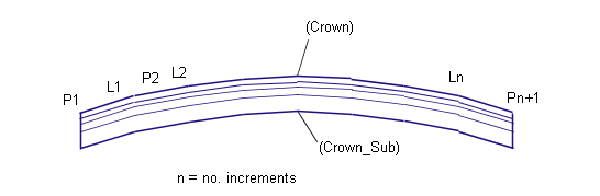

No. Increments |
Number of straight line increments simulating the parabolic shape |
Numeric, positive, even |
8 |

The center of the string line is calculated by subtracting the Crown Height from the attachment point, and the left and right edges-of-traveled-way are calculated by applying the Width and Slope symmetrically about the attachment point. The ordinates of the parabolic curve are calculated at even intervals along the string line, and straight line links are added to connect the ordinate points. Parallel surfaces are inserted for the Pave1, Pave2, Base, and Subbase surfaces from the given depths.
