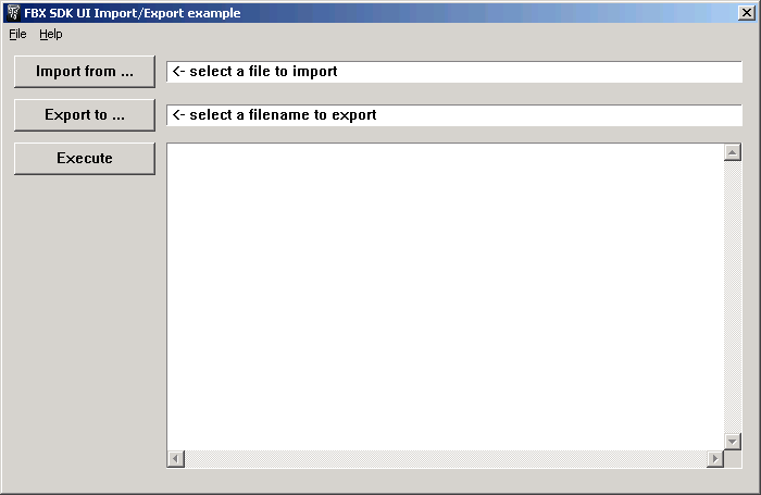

Tutorial: ImportExport
The ImportExport tutorial program shows how to convert a file from one file format
(FBX binary, FBX ASCII, DAE, etc.) to another. For more information, see Importing and Exporting a Scene.
Operations include:
- Building and running a sample program using Visual Studio.
- Managing memory with SDK Manager.
- Creating an empty scene.
- Creating a file importer.
- Loading the import file into the scene.
- Creating a file exporter.
- Specifying the file format of the export file.
- Specifying whether media are embedded in the export file.
- Exporting the scene to the export file.
- Cleaning up and shutting down.
NOTE:Builds and runs on Windows only.
